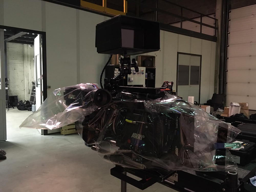

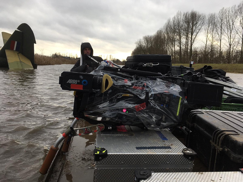

Rozemarijn On 12/18/19, 7:51 PM Hey Jacob, I had to ask my 2nd to be very honest. He does an amazing job in covering up the entire setup in the blink of an eye. I have added some photos. He is using a see-trough table cloth which he buys at the budget store here in Holland. (Action) Which is very nice because you can still see the buttons. Strapping it with an elastic band or coco clips. As far as overheating, just dont leave it on all the time, like Gunnar says. And we also use the backpack covers, but they are obviously not transparant.
