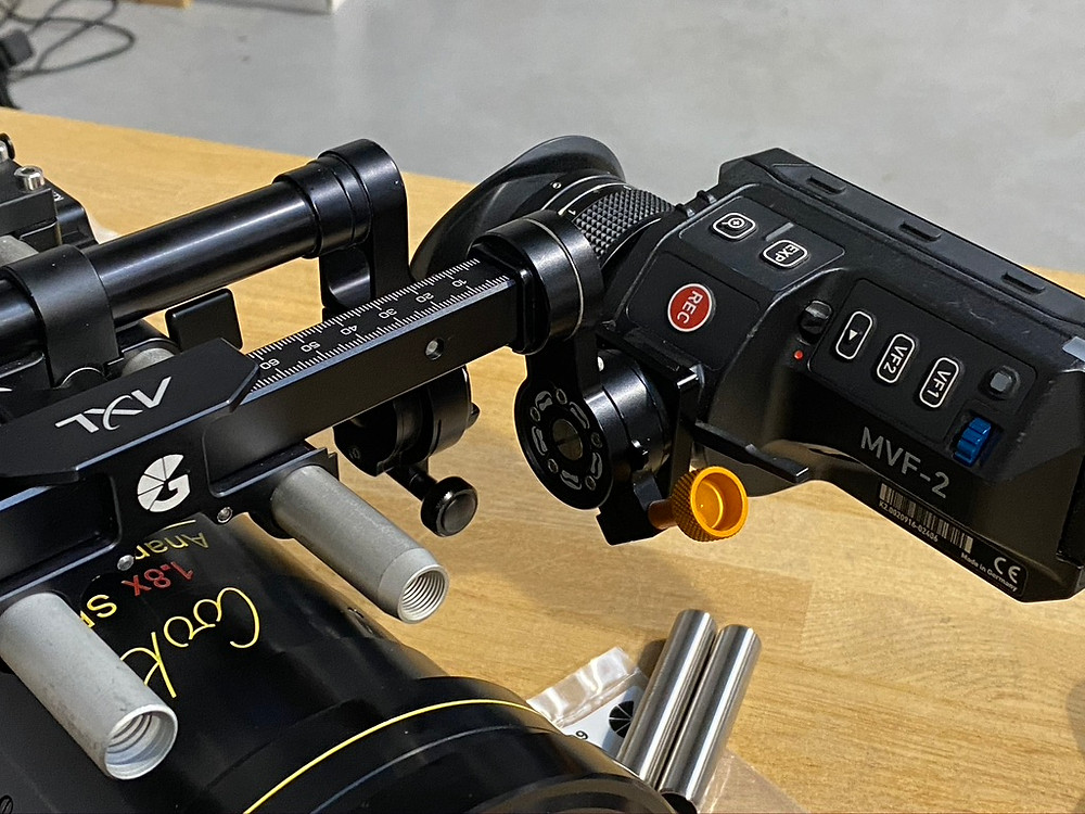

The Axl is Bright Tangerine's newest addition to camera "hardware". It's a multipurpose view-finder bracket that you can use on various cameras and viewfinders. It utilizes 15mm rods to hold the bracket on nearly every camera set-up that has these rods attached to their camera.
On their website you can find various bracket attachments for different viewfinders.

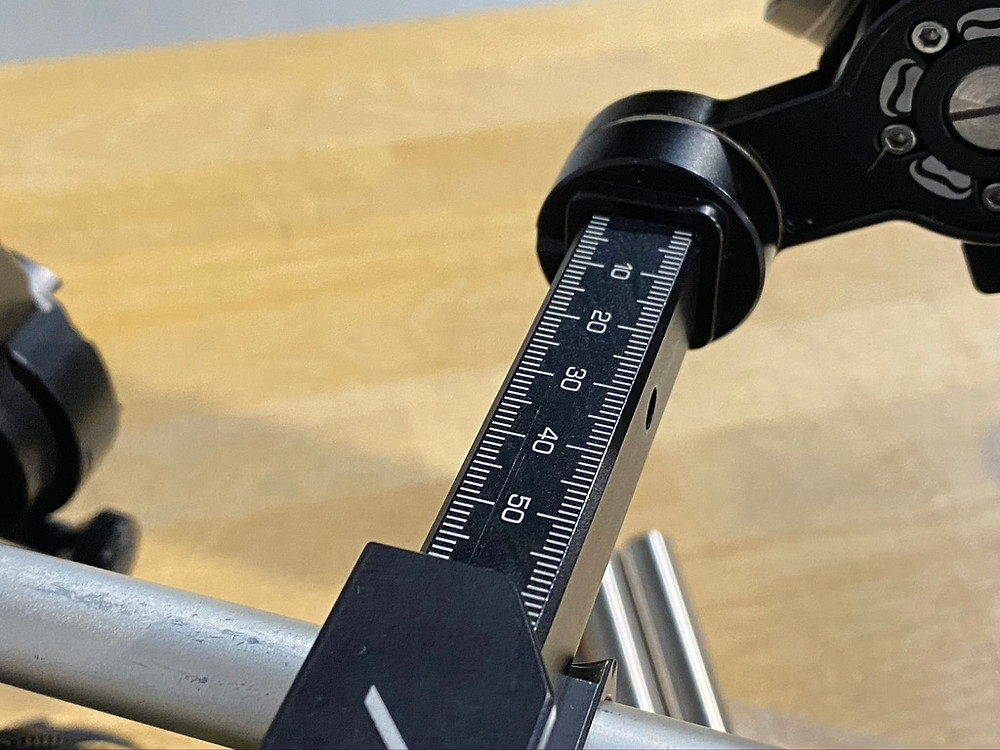

At this current time I'm testing the EVF bracket for common Arri viewfinders such as the MVF-1 and MVF-2. But they have brackets for Canon, Sony, Zacuto aswel. On the top there is an engraving with numbers so you can set the preferred position as well.

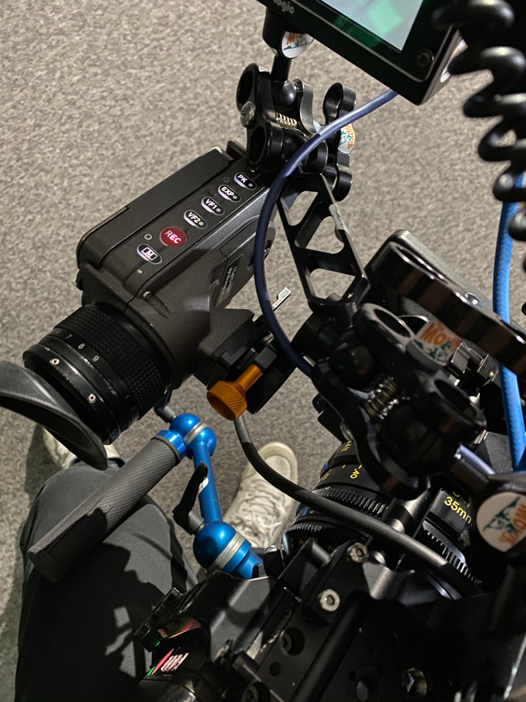

A week later I had the chance to shoot with David Doom, also a befriended DOP of mine.
He is also very picky about the position of the viewfinder, especially because he is left-eyed, so the viewfinder has to be more to the left. I had to rig a 3D goggle on the camera with direct feed of that system on 1 monitor and live-feed of the camera on another monitor.
This is what he had to say:
"Feels like a breath of fresh air. Finally a viewfinder bracket that can slide FAR away from the body. I need this space because I'm used to use the viewfinder with my left eye. Other viewfinder brackets come a little short and this is just perfect."

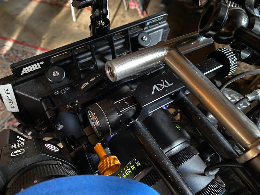

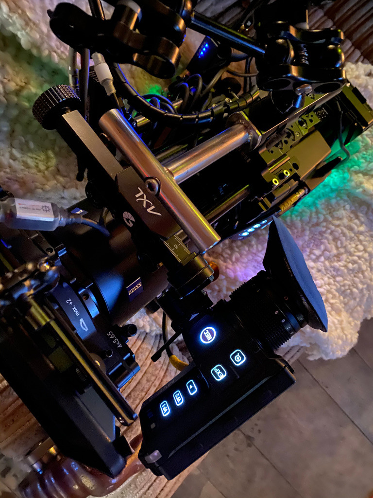

Two shoots later I had the chance to work with DOP Bjorn Charpentier (SBC). As myself he is a real "gear-nerd" and thinks out his set-up very well before hand. We had a hand-held shoot this day in the snow.
I reached out and asked him to play with it during the shoot.
These are his findings:
"The Axl is very well built, and the quality of used metal is gorgeous. With the original viewfinder-bracket (nb. Arri) it's sometimes a struggle because the butterfly screw is hard to reach due to the mounting of Cinetapes / UDM's and such. The large screw works well, but it would be much nicer to have to closer to the viewfinder. Preferable on top of the camera, so IF would need to adjust it, it's easier to reach. Personal taste: I like the knob due to it's practicality but aesthetically it would be nice to have it a bit smaller.
The length of the viewfinder bracket could be a little bit longer, but for hand-held shoots it's enough. When I set-up my viewfinder I don't move it anymore during the shoot.
I also had the chance to use the Axl on a more studio set-up (dolly, slider, tripod).
Here I found out that when retracting and pulling the Axl in it "bumps" against the focus-pullers' motors due to the size of the knob. Not a "real" issue, but assistants could get mad haha.
"the original Arri VF works, but the Axl is better. It's like the icing on top of the cake."
